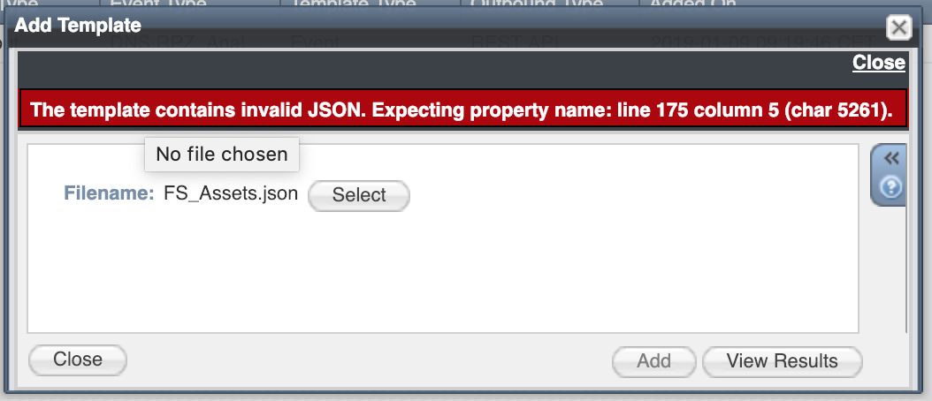

When I try to import the Forescout assets template (FS_Assets.json.txt) in Infoblox (version 8.2 and 8.3) , I get an error indicating that the json file is malformed.
The exact error:
The template contains invalid JSON. Expecting property name : line 175 column 5 (char 5261).
Another thing is that I can’t select a template in the outbound endpoint – Rest API configuration. Probably, this problem is linked to the previous.
How can i solve this? Can you check the json template?

The block opening at line 165 does not seam to close properly.
Adding a close of the curly bracket gets the syntax error out of the script.
Also the indentation of that block seams to be off, so it could be there is some other stuff missing in the template.
I did not test that the json file is now working, but can you try the attached one?
this is the unclosed block which I closed with "},"
"name": "check_For_Discovery_Information",
"operation": "CONDITION",
"condition": {
"condition_type": "AND",
"statements": [{"left": "${P::discovered_data}","op": "!=","right": ""}],
"eval": "${XC:COPY:{L:discovered_data}:{P:discovered_data}}",
"else_eval": "${XC:ASSIGN:{L:discovered_data}:{S:.}}"
},0
