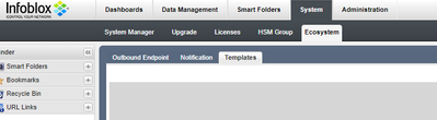

The templates are JSON files (available at the bottom) which you upload to Infoblox on the templates tab.
Fig 3. Templates overview

Use the following steps to upload the templates.
- In Infoblox go to the System tab, Ecosystem sub-tab, Templates sub-sub-tab.
Fig 6. Tabs - Click on the + button to open the Add Template screen.
- Select the template file and click Upload.
- Click the Add button to add the template to the template list.
- Repeat steps 2-4 for all template files in this order: PA_login.json, PA_session.json, PA_actions.json.
Fig 7. Templates overview
