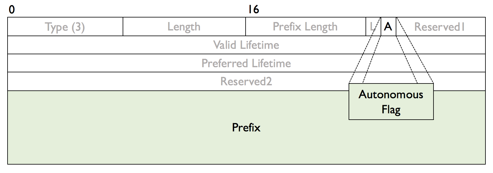

The message format for the Prefix Information Option (Figure 3) includes two fields that are critical for the proper functioning of SLAAC.
Figure 3: The A flag and Prefix fields of the Prefix Information Option
The Prefix field contains an IPv6 prefix to be used by the client as part of the SLAAC process to construct an IPv6 address that is global in scope: Recall that the client already has a configured link-local address that facilitates communication with other IPv6 node on the same link. You can also expect to see that the prefix is a /64 which is the standard prefix length for server or desktop access networks.
When the A (or autonomous address-configuration) flag is set to “1”, it specifies that the included prefix can be used for SLAAC. Thus, the Prefix Information Option message must include both a prefix and the A flag set to one for SLAAC to function properly.
