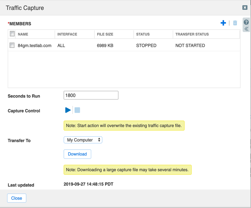

Instructions for configuring packet capture:
1. Log into the GUI.
2. Navigate to Grid --> Grid Manager --> Members --> Toolbar --> Traffic Capture.
3. Click on Traffic Capture on the lower right side of the screen.
4. You will need to add a member in which to capture packets. Click on the ‘+’ button to do so.
5. Select a member by double-clicking on it.
6. Click on the Interface drop down menu to select the interface to capture traffic. If you do not, the packets captured will not have any source or destination MAC address information in the display of the packet.
7. Click on the ‘play’ button to start the packet capture
8. At this point you can close this window and go make any changes on the GUI and then reinvoke the packet capture screen. The packet capture will still run until the duration time of 1800 seconds or stopped before the end of the duration by hitting the ‘stop’ button.
9. Click on the member and then click on the ‘Download’ button to download the capture file. The file will be in a .tar.gz format. Uncompressing the file and the name will be traffic<number>.cap. You can now import this file into Wireshark to view.
