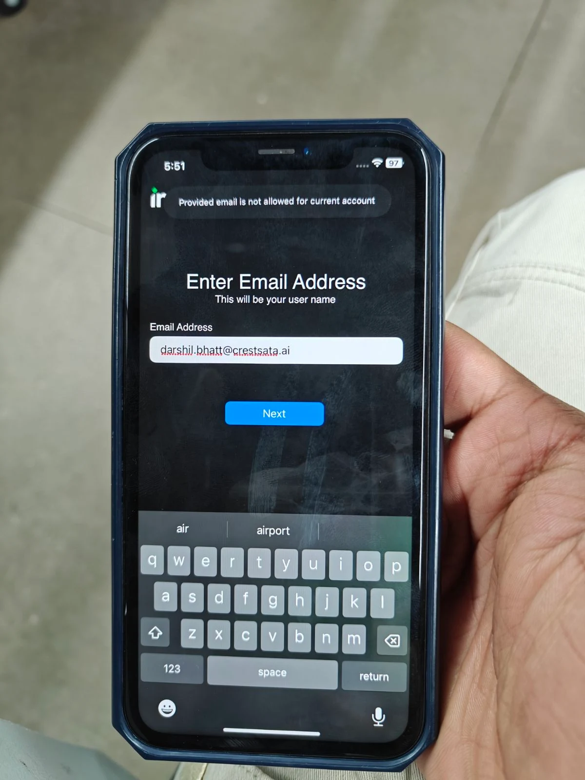

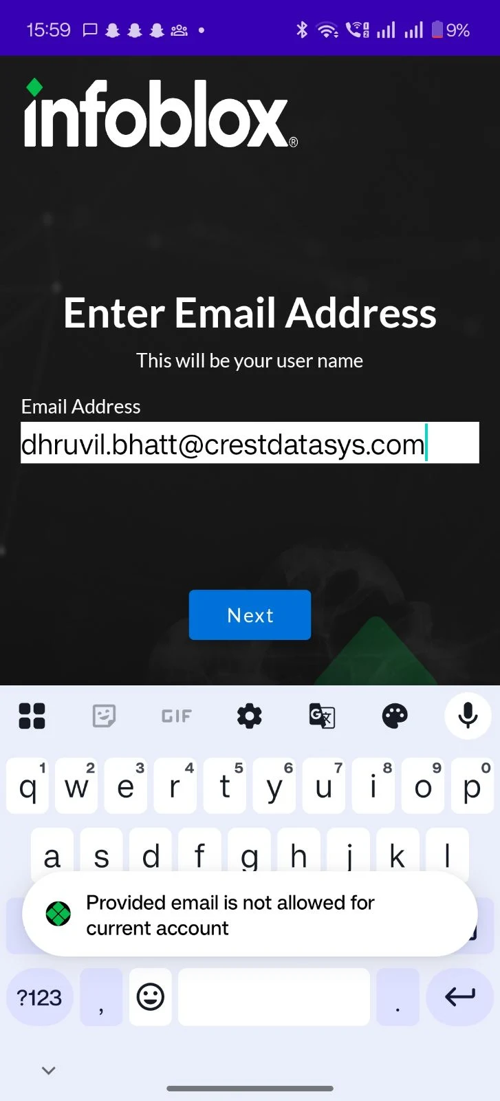

I am trying to connect Mobile devices to Infoblox BloxOne DDI Endpoint but while configuring I am getting the error that provided email is not allowed for current account. Can someone help to debug it?

The link above is to a KB article that provides the answer to this error.
It is mandatory to add the domain/s of the email addresses in the Endpoint Group - Mobile Endpoint Domains configuration.
Navigate to Configure>>Security>>Endpoints>>Select and Edit the Endpoint Group>>Mobile Endpoint Domains>>Add the Domain/s
Thanks for the clarification! That makes sense — adding the domain under Mobile Endpoint Domains fixed the issue. Appreciate the detailed steps!
