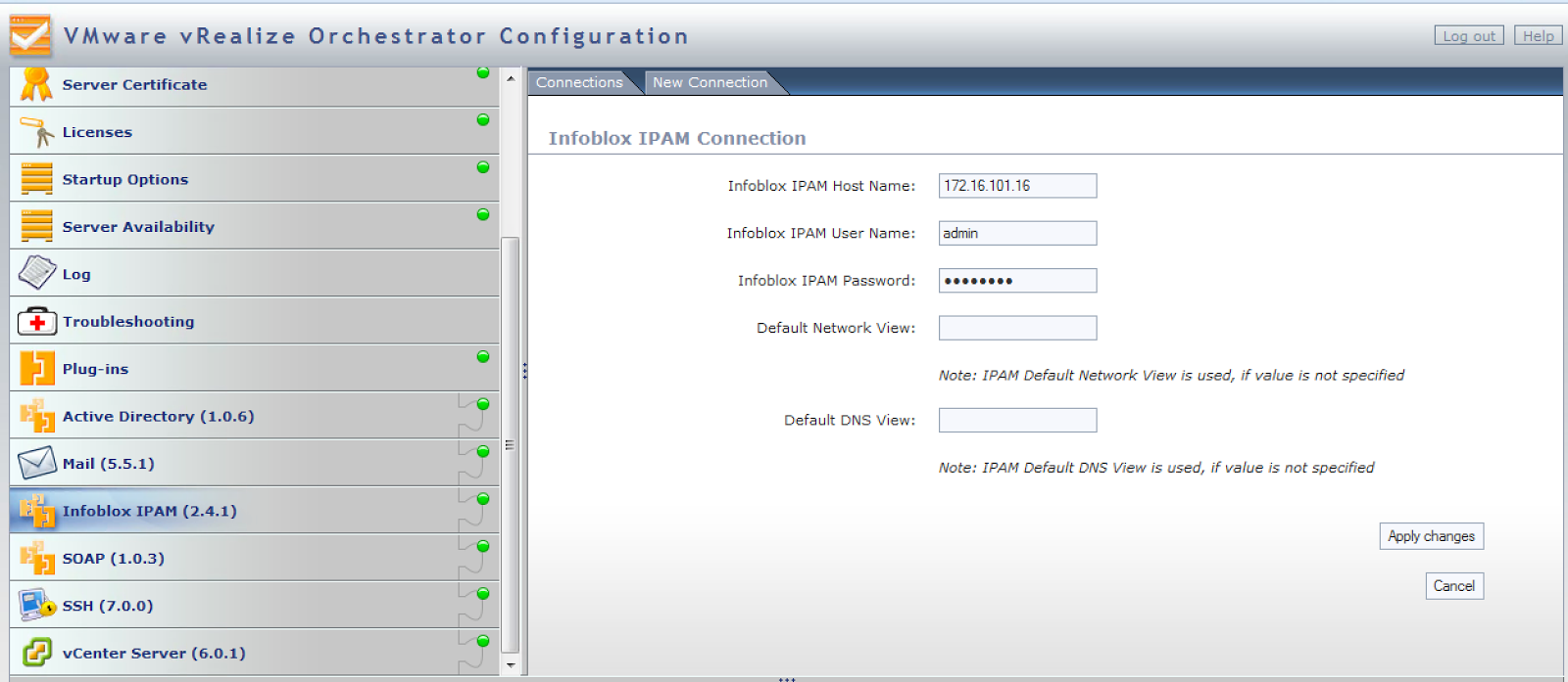

Deployment of the plug-in was similarly fairly easy, and documentation is provided with the plug-in itself (for which you need to register, here:https://www.infoblox.com/downloads/software/vmware-vcenter-orchestrator-plug-in).
Two quirks of note that I discovered:
- I could not register the vNIOS appliance to the plug-in using the FQDN. I believe this was because the appliance FQDN was a “.local” domain, and deemed as invalid. Using the IP address got around this problem, and the error message made it pretty clear that it was not happy with DNS validity, so it wasn’t hard to drill down to what alternatives to try.

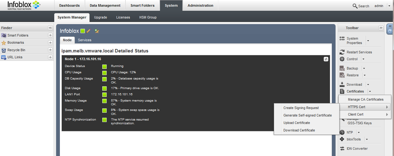

- The self-signed certificate was expired. It appears that the default certificate generated has a lifetime of one year. This was only an issue for me when trying to connect the plug-in. Again, fairly easily fixed – this time through the Infoblox System Manager web app under System – Certificates.

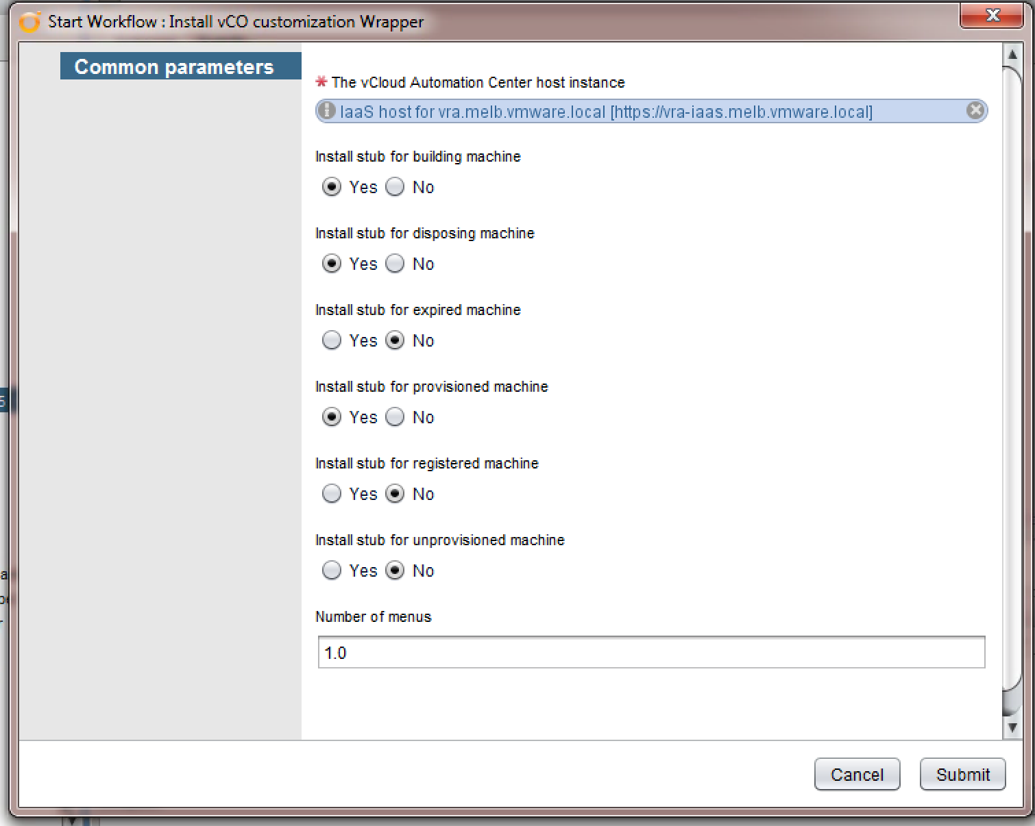

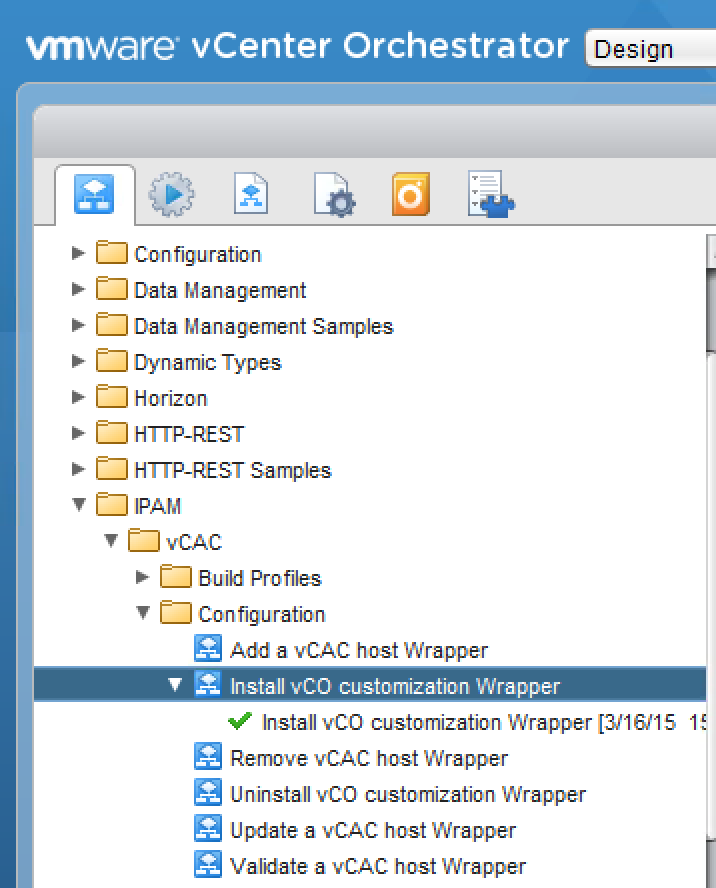

Once I installed the plug-in for my setup, I used the provided Infoblox vRO workflows to:
- “Install vCO customization wrapper”.
This enabled vRA to call out to Infoblox via vRO (aka vCO) during three distinct lifecycle stages:
- Building – this stage is where IP addressing is reserved in IPAM and passed back into vRA during the initial provisioning.
- Provisioned – once the machine is built, this calls out to the workflow “Update MAC address for vCAC VM wrapper”, which appears to grab the as-built MAC address from the VM (nic0) in order to populate Infoblox with this detail.
- Disposing – when the machine is destroyed, this calls-out to “Remove Host Record or A/PTR/CNAME/Fixed address/Reservation of vCAC VM wrapper”. In essence, this removes the entries made by the previous workflows.

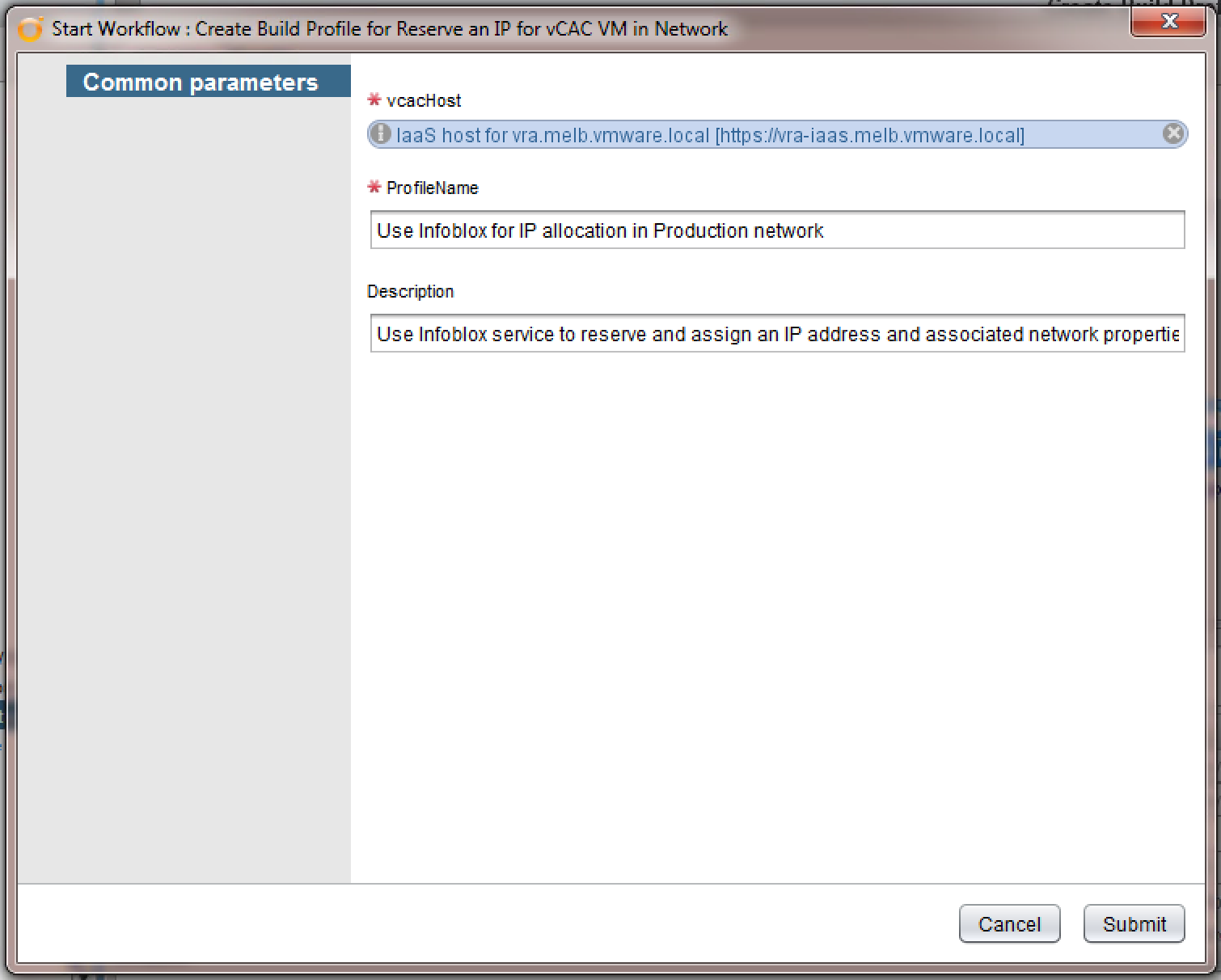

- “Create Build Profile for Reserve an IP for a vCAC VM in Network”. This piece of absolute magic sets up a new Build Profile in vRA so that I can merely select it during blueprint definition to enable IPAM integration. Magic!!
I used the “
in Network” method of IP allocation, because I just wanted Infoblox to pick the next address within a given subnet range. I already have certain ranges carved out and reserved for other purposes (such as vRA’s own ranges that it manages, more on that later) – so anything that wasn’t already reserved is free game for Infoblox to grab. The other methods are “
in Range” (if you have specifically carved out one in Infoblox for this purpose), or “
general” (if the IP address to reserve is already known, perhaps through an external process prior to the request).
