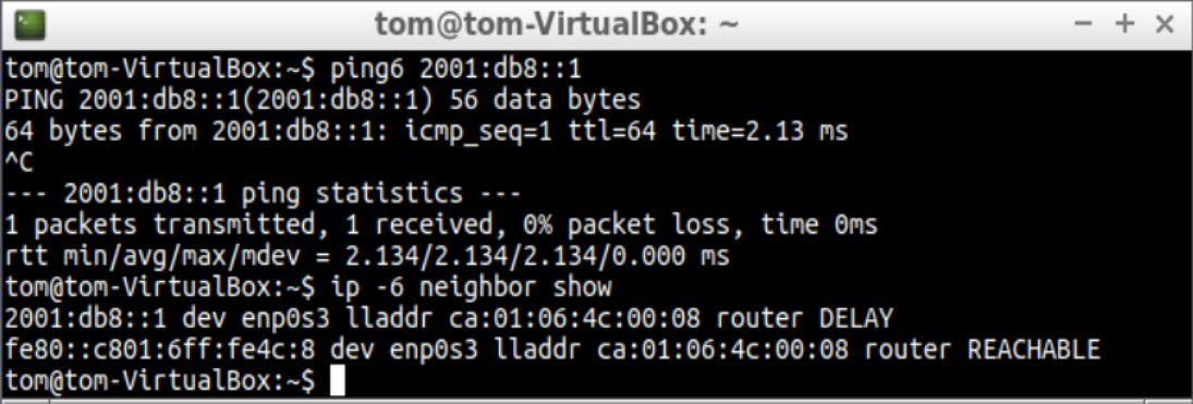

Now let’s look at the neighbor discover cache on the host. The command for most Linux systems is ip -6 neigh show:
As with our router example, we’ll go ahead and send a ping to force the IPv6 neighbor discovery cache state to change for the entry that is currently listed as stale:
Upon completion of the ping, we run the ip -6 neigh show command again and notice that the status of the entry is now listed as delay.
Recall from our last post that a status of delay indicates that, though the ReachableTime has expired, a packet was recently sent to the cache entry’s address by an upper-layer protocol. After a defined interval, a Neighbor Solicitation is sent and the ND cache entry is changed to probe status. The delay status merely provides time for upper-layer protocols to potentially refresh the cache entry without resorting to a Neighbor Solicitation.
Had we been running a packet capture, after sending the ping we would see the router issue a Neighbor Solicitation and the entry state would briefly change to probe before updating to reachable again.
