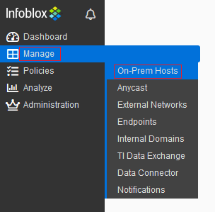

-Login to https://csp.infoblox.com with your credentials.
-Navigate to Manage>On-Prem Hosts.
-Click on “Create On-Prem Host”.
