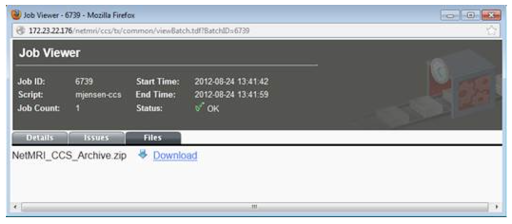

Once a job batch completes, all of the related ARCHIVE files will automatically be copied into a single ZIP file, which can be collected from the “Files” tab of the Job Viewer (not the Job Details Viewer):
Undocumented Feature Alert: Note that this ZIP file only contains *.txt files. That means it will not be created unless you change the ARCHIVE filename to something besides the default (which has a .log extension instead of .txt).
